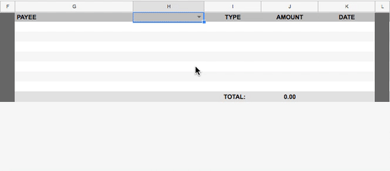

Next to my invoice log, I have repeated the header, except for the “show” column.
Using the FILTER function, we are going to list all the invoices that relate to a specific show, then tally the amounts. You can see that I have already created a “total” line at the bottom. This setup works in my case because I have very few lines. If you have hundreds of invoices, I would recommend tallying everything at the top of the page.
In Cell H2, I have set up a drop down menu based on column B. This way, I can only look up a show that exist in the list of invoices.

In cell G2, I type the following formula:
=IFERROR ( FILTER ( A:E , B:B = H1 ) )
Forget for a second about the IFERROR function. The FILTER function’s first argument is the cell range (columns A through E). Then, the condition for filtering is that column B is equal to cell H1.
I’ve wrapped the formula in the IFERROR function in order to avoid displaying a #N/A error when no show is entered in cell H1.
If you select a show in cell H1, it will now list all the invoices that match that name.
